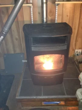

Hello
Santa Fe is a good choice. Simple to operate and not fussy on pellets. Also they are reliable and easy to clean.
I have worked on many stoves and have owned and rebuilt quite a few.
Right now I have 2 Santa Fe's and a pie warmer (The older Santa Fe called the Contour - it has a pie warming compartment in the top. :-)
One Santa Fe heats my garage and one heats my shed/workshop.
Below is a pic of my recently aquirred Contour!
Good luck with your choice.
