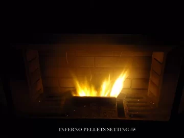

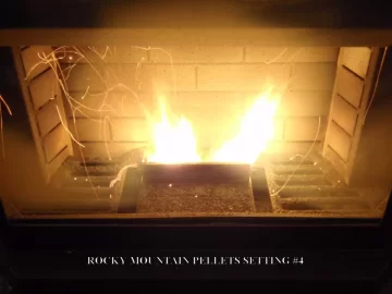

Well I had the wife stop at the stove shop today and she got a bag of Corinth and a bag of Rocky Mountain. Cleaned all the Inferno pellets out of the stove, lit it and ran it down to nothing then added the Rocky Mountains to start.
DEFINITE difference, not only in flame height but heat output too. It's markedly noticeable 4' in front of the insert. Wife noticed the difference too.
First pic is the Inferno on setting #5 on the insert.
Second pic is the Rocky Mountain on #4 setting.
BIG difference. The second picture is how that insert ran all last winter even with the crappy 1 ton of Michigan pellets in it.

Yes that is very noticable. The rockies are a pretty good pellet. The corinth are decent. I haven't tried them this year. But they were about average last year.
Have you ever burned softwood pellets in the past??
jay
No last year was our first year and it has been all hardwood.
