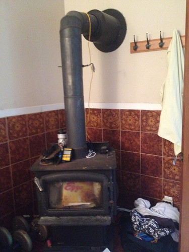

First I have a wood stove and a lined cinder block chimney, the liner has a crack and we are looing at aroound $1200 to reline. What I am thinking is to replace the wood with a pellet stove and run pipe right inside my old 6"chimney, is this possible? Right now my pipe is out the top of wood stove for 4' elbow through wall appox 2', elbow and up the chimney for approx 15'.

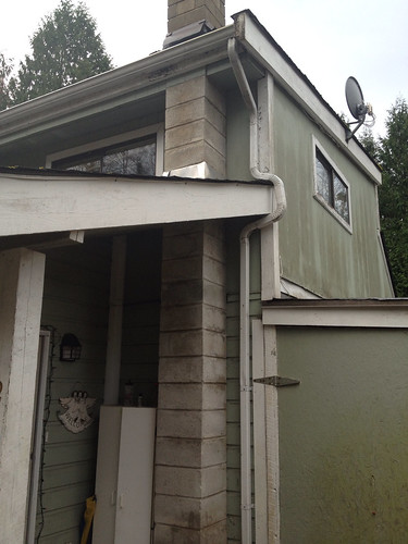

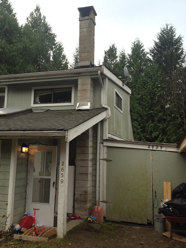

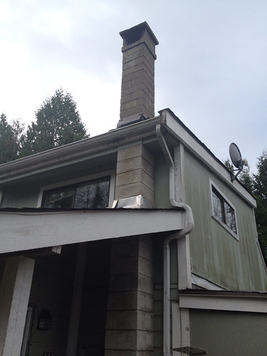

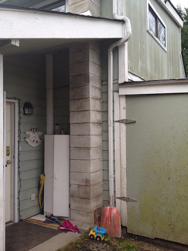

The stove is on interior wall that accesses the outside chimney, the chimney is 2' away from the front door of the house so don't think I can vent it there can I. It is not a shared chimney. I could take a picture of it and post it if that would help.

the only thing I've seen worse with a chimney in one built in front of a window...seen that a lot!...oh wait ...there was the one that stopped 12" below and 6" away from an upper roof!!
from what I see I would take down that chimney.. not attractive
