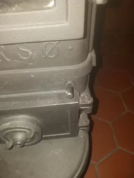

@Woody Stover Now that I know what every temp on the stove will be for whatever load I put in, I rarely even check anything anymore. I don't sit close enough to hit the flue with a laser or see the surface thermometer, it might as well be unknown anyway. Really though, if the stove has secondaries going, then it's a safe bet your flue is hot. On most non cats if your load is too small, you will know because there is never any secondary burn. This will be obvious because your chimney will have smoke and smell like smoke, rather than nothing or steam. My stove can also be snuffed out if I close primary air all the way. It might take a bit, but it will die before the load is burned. The secondary air supply isn't quite enough air to sustain the fire on its own. For a while I really wanted to be able to adjust the secondary air, but I learned to work around it. The stove also has a shaker grate, but there is a gap around where the rod passes through the stove body. So this results in a tiny, tiny bit of air "leaking" into the ash chamber which means under fire air. I like to think of it as a non adjustable "boost air".
Side note: Allegedly my stove is a "multi fuel" stove in Europe and has an adjustable draft cap on the ash pan door, in the US this is not adjustable (but I've seen people make it adjustable). This allows the use of anthracite coal/smokeless briquettes.

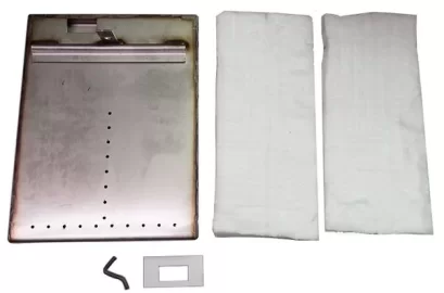

The T5 has boost air, an unregulated ~7/16" tube feeding in air from the ash pan area.
It just seems that they have made an concerted effort to "smolder-proof" this stove. I don't think I need that much "help" to figure out how to burn clean.

I probably should have included something for scale, but it's a tiny gap. I can just sometimes see cinders float up from the grate area.
