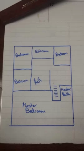

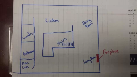

I have posted on here before and have pretty much decided on a osburn 2400 insert. I attached a horrible set of drawings of my house. Sorry im not an artist. The house is 2100 sqft., built in 1987 still has original windows and is fairly well insulated. Chimney is 25-30 ft fairly open downstairs with the stairs pointed directly down to the fireplace. Anyways just wanted to know your thoughts before i pull the trigger on the osburn 2400. Thanks for any advice either for or against. I just want to make the right decision. Oh and I live in southern maryland. By no means bitter cold but we get our share of temps in the teens and twenties during the winter.

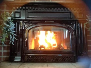

If that's what you want I would definitely get it, I love mine and wouldn't trade it or the world...[Hearth.com] Input on wood stove insert [ATTACH103898[/ATTACH]

No need to apologize for the floorplan, that works fine. It looks like you will get decent convection throughout the house. The Osburn 2400 should do the job for you.

It may be unnecessary, heat will try to convect upward if possible. I'd try it without first. We don't need one in our house.

A small table fan on the floor blowing from the kitchen towards your man cave will help even out the heat on the first floor. As the warm air is pulled past the stairwell a little extra heat will make its way upstairs.

That's a nice floor plan for wood heat. I like it.
If needed, a fan at the top of the stairs blowing down should really help circulate the heat.
