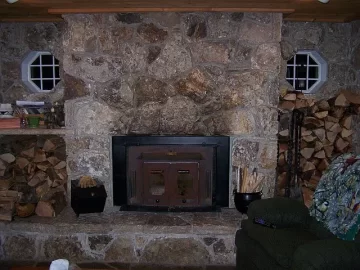

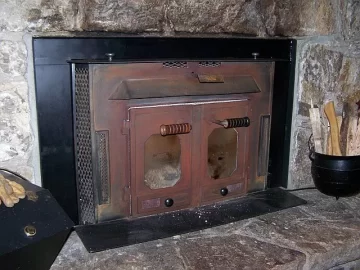

My insert came with surround plates, and because the stone work is REALLY rough, I decided to do an inside fit with the surrounds. I matched the lintel with two pieces of 1/4" plate, mortared them to the sides of the fireplace, and trimmed the surround peices down to fit about an inch from the out side edge. Much neater appearance. I didn't use a block off plate, just fiberglass insulation.
