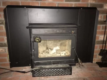

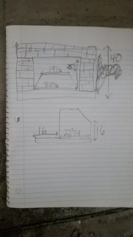

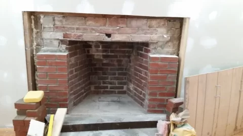

I'm in the process of re building the exterior of a fireplace on a house in moving into shortly. I have added a picture and some measurements from a quick sketch I drew up. I plan on addind 5 rows of brick all the way across from this point up to where i build the mantle. you can see the fireplace slopes and angles in. I would like to run it as an open fireplace for this winter then find an insert during the summer for next year. The entire room is only 11x17 so i think a wood stove is out of the question. If there are any small enough ones to use I'm open to that bit don't want to extend the hearth out based on the size of the room. It is a ranch and there is a big opening into the dining living area. What are my options? I have done some research and see alot of square back inserts. I'd prefer to find something used with a glass screen for viewing. Thanks. [Hearth.com] Insert for a fireplace

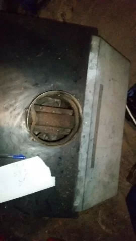

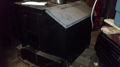

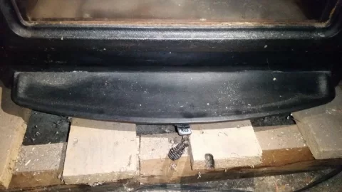

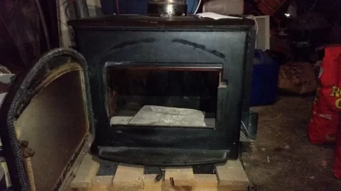

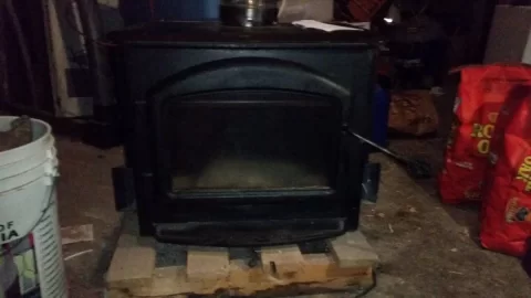

Can anyone ID this stove? I took a look at it. The owner thinks it's a lopi. Looks like it may fit. I just want to know more and look up all the specs on it. [Hearth.com] Insert for a fireplace [Hearth.com] Insert for a fireplace [Hearth.com] Insert for a fireplace [Hearth.com] Insert for a fireplace [Hearth.com] Insert for a fireplace
I think not a Lopi, too bad someone painted over the stove label.
Paint over the label could actually be a problem for your insurance (not least because you don't know what required clearances are). Pass on that one.
Ya I was a little Un sure about the no label thing. The firebox has red fire brick that needs some re pointing. (Previous owner must've used the fireplace. It has some normal wear) I'm just re building the outside. It was painted brick and the roof had leaked so I some rot along the right side and decided to take it all down and go for the natural brick. Guess it seemed too good to be true. The guy was nice just didn't know much about the stove so I figured I'd research it before going any further.

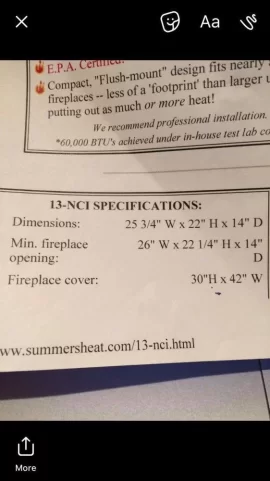

Just found an englander 13 nci from the original owner back in 2009. Looking at the demensions it says I need a 26 inch width at a depth of 14 inches, but the stove is 25 3/4. My firebox tapers in and at the 14 inch depth the width is 25 3/4. Can I push the stove up against the brick or pull the insert out just enough to make it fit? I added a picture of the tag he sent me on the rear of the stove. Also what is a decent price for this stove used since 2009? [Hearth.com] Insert for a fireplace[Hearth.com] Insert for a fireplace
Yes, it's possible , but double check measurements. Is the depth of the fireplace being measured at the top of the insert height or at the hearth floor level? The value is hard to tell, but maybe $400? The insert can be picked up new for about $900.
