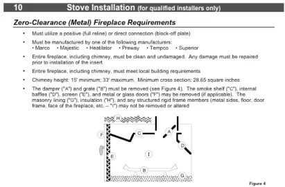

It's not really a matter of what we think, it is a matter of the listing and label on the particular insert you are looking to purchase. My initial opinion would be that an ancient preway like that would not be approved by the insert manufacturer. This would be easy enough to check by going to the manufacturers site and downloading the manual - and/or checking with the installing dealer and local code authorities.
The inserts that I know of which are approved for ZC usually state the exact brands, and sometimes even the models within the brands. Some may be more vague than that.....
All in all, I don't really like the idea of installing something in an ancient prefab like that....it is more than likely 30 years old, and that is the design life of a prefab fireplace. Also, you may have condo restrictions which you don't know about, etc.

Note that the enclosed snippet from the Lopi Revere manual does mention Preway, so you probably have covered #1 and #2 above......
