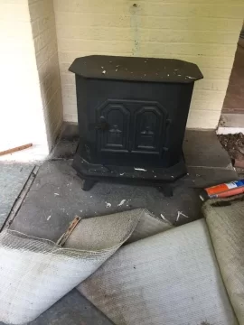

Hey everyone. I have been reading a lot about fireplace inserts and I am strongly considering one for the basement fireplace to assist with heating the home during the winter months and making the basement fireplace more usable. We did not use the fireplace at all last year because we don't spend a lot of consecutive time down there. It is a finished area and primarily a rec room/play room for the kids. I have a workshop down there as well and it is pretty chilly in the winter.
I have a walkout basement slider that enters to a covered stairway and I was thinking that I could stack wood along the wall and keep it covered to feed the insert.
Anyway, I am not looking at investing a lot of money in it at this point because we recently moved in and the basement will need to be updated in a few years. I found a local insert for sale that has a electric blower but I am not sure of the make/model of it. I have to see if it fits and do have the dims.
I will need to add a flu liner and extend this up the dedicated chimney but I was hoping you could identify this unit and provide me any information on it. Thank you.

Depending on the age of the insert, there should be a plate on it. Does the seller not have that info?
I am working on trying to get that information but wont have it for a few days. I was hoping I can identify it so that I could do some research, get dimensions and determine how it hooks up.
Edit** The guy who is selling it is at the house now. It looks like he is renovating it and that is why he is selling it. He cannot locate any brand or model identifiers.
1) He is only asking $150 Obo - Ultimately I would upgrade to a nice one after a few years but since this is my first experience with an insert I want to crawl first.
2) It looks like it is pretty old and has the rectangle exhaust. From reading on hear, I would need to fit an adapter on this to accommodate a 6" liner. How big of a pain is that?

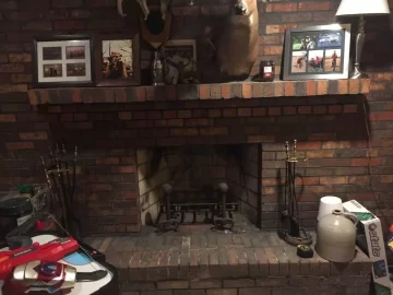

3) It is 16 inches deep off of the face plate portion and 26.5 wide at the rear. I have to verify that it will fit into my fireplace since the sides of my firebox angle in. I know that the front width of my fireplace is 36" and the rear is 21" but I forgot to measure the depth....

Looking for an insert for this.

That is an old dogger set up for a slammer install. Check with your insurance company to see if they will allow it. If you still want it, measure carefully.
I am not interested in a slammer install. I was under the impression that you could use a rectangle to round insert adapter to connect to a flue liner. Maybe it is worth passing on at this time even at $150.
Do you see any other issues or concerns that tell me I should walk away? I want one but I am not in a position to invest in a new model at this time. This is kind of a trial by fire...literally.
I know nothing about the insert so it's hard to comment. If it's just a big metal box with no baffle or firebrick then it will chew through wood pretty quickly. These features could possibly be added as a retrofit to improve performance depending on the stove design. If it does have firebrick lining and a baffle then that will help it heat better using less wood. It looks like there may be two upper air controls. If so this may be for an air wash, or maybe secondary air, not sure. It looks like it has a blower. If so does it work?

I would pass on both the insert looks like a buck copy it would need a boot and an 8" liner and honestly with that crack in the top it is scrap. The garrison is not a great stove either they are built from pretty thin metal and are not designed all that well.
Measure up the rectangular opening size and match its area with the pipe area. 6" round = ~28 sq in. 8" r = ~50 sq in., so if the opening is 3" x 16" it will need an 8" r liner.

I know this topic hasn't been posted in for about a month, but I'll post just incase someone has that same insert in their home. From the pictures it looks to be an old Squire. I have one installed with a 25ft 6" flue in an interior chimney and it works great for being older than I am. It chews through wood though like mentioned. Good old inserts but I would recommend a more efficient one unless you have plenty of seasoned wood to burn.
