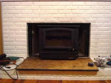

Id say go with an isert if you can find one big enough to fit in your ZC box... I installed a Buck model 74 in my Tempco 2 years ago and have never looked back... Our house is a Cape Cod 2900 sq' and I heat my entire house with my insert and teh ceiling fans running... My daughters upstair do have small electric heaters on timers in their bathrooms to warm them up a bit in the morning before they get out of bed but thats it... I am in Georgia and not up north but the heat output of my insert is phenominal My praises to Buck Stoves... heres a shot of my buck with without the trim kit...
