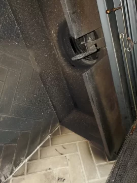

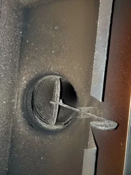

Existing firebox is about 20 years old. Fire brick lined, metal flue damper area firebrick bottom. 48 wide, 35 high, 20 deep. Looking to put an Osburn 3500 or Hearthstone Clydesdale in. This is not a masonry chimney. It is simply a 10 inch double walled pipe straight up and out to a cap. About 20 feet long. Want to heat my 2100sqft home in Alaska. Primary wood, with natural gas intermittent when it gets super cold.
Can this be direct fitted with an adapter I do need to spring for the liner as well?
Thank you in advance.

Chances are you are not allowed to install an insert in that prefab fireplace at all. What model is the fireplace?

There's no discernable model or info markings anywhere. Plan is to rip it out either way. I would imagine I could still use the existing 10" chimney for an insert with a liner through it? I'm going to start remove ng the front panels today and see if it has any info on it.
Starting to realize this may not be as easy as I thought. If it's not an option, what are my options? Primary goal is HEAT. Sounds like I may need to be looking at a "Fireplace" and not an Insert, that still provides a closed box and blower.

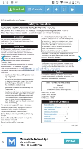

EDIT: Majestic SHR48 is my fireplace. Found the plate covered in soot inside the top of the box.

You absolutely cannot remove the fireplace and put an insert in the opening. An insert is meant to go into a working woodburning fireplace only

Read the top line of the second column. Inserts are not allowed

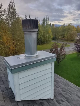

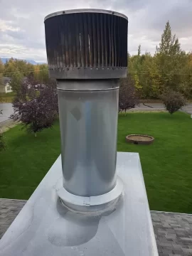

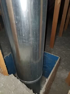

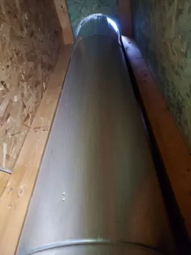

Deciding to go ZC. Just don't want to lose more space in the room. Infant starting to crawl etc. The biggest question I have is this existing chimney I have. If the ZC recommend 8" class A (like 20 manufactures approved, Valcourt Waterloo) can a bigger diameter be used? I would understand smaller is a no go. I cannot seem to identify what I have from the exterior. Seems I have to take a section apart. Was quoted 3300 just for a 20ft straight up no bends chimney replace. Obviously if I could source it myself or retain the use of the existing that's the rout I want to go. Seems to be 10 inch ID and 12 OD This is my chimney situation:
Attic upward
Attic looking down through ceiling
Attic upward
View attachment 298994 View attachment 298996 View attachment 298997
No the chimney needs to be exactly what is specified in the manual
