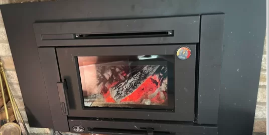

Ive been using my insert and I've been learning about proper usage. I don't have access to the flue, but I'd like to get an accurate temperature reading for proper usage. I've tried this magnetic gauge, but are there recommendations on its placement to give an accurate reading?

Also, should I assume that this reading is accurate or that I should increase this amount because it is outside and is not getting the flue reading?

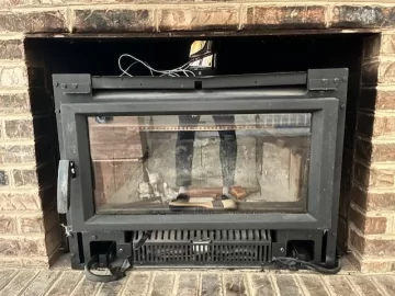

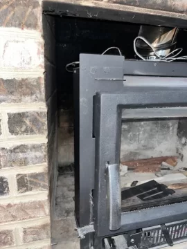

Hi. I just happened to stumble across this thread and seeing as how insert insulation techniques is something I'm just starting to research I'm hoping someone can answer a question about insulating with ceramic insulation blankets.
I have a 6+ yr old Regency CI2600 that I think I'd like to try an retro insulate (I say retro because it ain't coming out). There is about a 3-4" gap on almost all sides between the metal insert surfaces and the walls of the brick firebox. Would it be ok to just lay some ceramic insulation blankets across the top of the insert and stuff the gaps with more ceramic insulation? Is it ok for the ceramic insulation to touch the metal insert surfaces? This stuff is suppose to with stand 2300 degrees and I can't imagine the insert surfaces ever getting that hot!
Any advice, or questions, would be appreciated. Thank you.
It won't relate much to the flue temp; it's far away and will lag far behind the actual flue temp.
Yes it's fine to touch.
I would only insulate the wall to the outside of the home - if any. Nothing else.
Thank you for the response, but I'm not really sure what you mean by "only insulate the wall to the outside of the home". Are you saying that insulating around the insert will not help unless the brick fireplace/chimney is on an outside wall? For the record it's not, there is a sun room on the other side.
Am I miss understanding of how this all works? My understanding from all I've read on this subject is that insulating the area around the insert might make it a little more efficient, burn a little less wood or possibly produce more heat from the wood it does burn. I'm thinking of just insulating the open areas between the brick fire box and the insert sides, back & top. Possibly the attached photos would help.

I don't think it'll give any benefit if the insulation doesn't prevent heat from leaving the home.
The wall with the sunroom might be worth it, but the other walls not; any heat you prevent from going there is heat you prevent from entering your home.
The additional 0.1% efficiency you might get is not noticeable and not worth it.
You might even end up with more heat going up the flue because it's not shed into your home...
