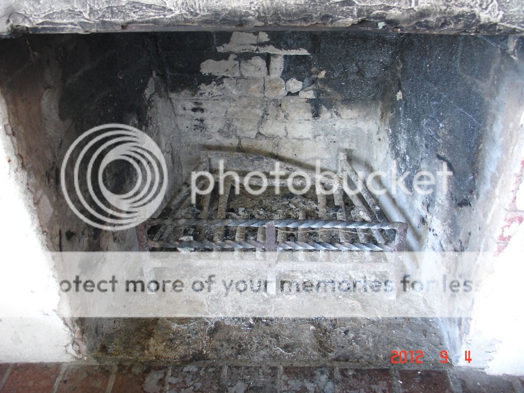

So here's some photos. The flue actually does not go right up the center, but off up to the right - so as to miss the viga. It might look funny, but one could install a side-loader off-center, to the right, and gain use of the side door and a straighter shot for the vent. It's an oddly-shaped fireplace... 29 x 26, nearly square, and very deep. The smoke smudging that you see between the lintel and mantlepiece comes more from having big fires with the wood not pushed far enough back, than from poor drafting. (The mantlepiece is non-combustible). The final photo is peering down the chimney, that shows a really good look at the shortcut someone took ninety years ago. Actually, it's probably more accurate to say they were making do the best they could with what was on hand out in the middle of nowhere with no money.

If you placed a marble on the right side of your mantle and let it go, would it run off the left side or is that just the camera angle?
Just curious, my house is far from perfect!

LOL, that is mostly my crooked camera. But look closely at the ceiling... it looks bowed, but the plaster has not cracked, so I am thinking it was built that way. The roof on top (two or more built up layers) is not bowed.
Where your marble would roll the fastest would be the floor in a bedroom far enough away from this fireplace that it won't feel much heat. (Although this bedroom has its own fireplace; the house has SIX chimneys, 2 of which I plan to use.) Some out-of-work sheepherder -errr - architect, sloped a roof to pour off right into a garden plot of iris, right at the base of the building. No gutters, no drainage. And then people turned on the sprinkler as well. Granted, we are in New Mexico and not coastal Washington, but still, how could it NOT settle and sink.
