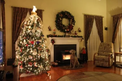

I went with an insert because I was replacing am LP gas insert. I wanted it to look nice and cause as little as possible work. Yes you have to slide it out for the deep cleaning. I think the biggest drawback is the ash pan on mine. I have to clean it every 3-5 days. My house is 5 bedroom 3100 feet and the room in this photo is 18x24 with an 18 foot ceiling. it is just the 2 of us and I close all the doors except our bedroom. On our coldest nights it can get to 58 in our bedroom.
i assume that your house is two levels. that sounds like the stove is doing a pretty nice job heating an area that size. our downstairs is pretty much wide open from the family room through the kitchen take a left to the dinning room and living and with an open foyer to the upstairs. there our no doors on any rooms downstairs they are all cased openings so hopefully the heat will move right through.
i love the dog we have a german shorthaired pointer very similiar to your weimeriner.

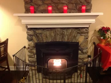

I'm happy with my Accentra insert. I get a lot of compliments. I run it almost all the time in the winter. I have a very open floor plan in a 100 year old lake house.(under insulated and drafty, working on that) if I keep it clean it keeps the 1st floor mid 70's , 2nd floor 60's. I have never maxed out the stove so it definitely has more to give :)
However everything stated so far is correct. My stove is on rails so not to big of a deal to pull it out once in awhile. I installed a full liner for my exhaust. Hopefully I'm going to install my OAK next week. That is a little more involved and cost more than if I had a free stander. It is still straightforward and doable.
