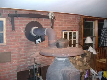

Here is a pic of my lil beauty.

That's a pretty unique stove you got there. I bet it burns through a good bit of wood. Some people can be sensitive from the wood smoke or dust and ash that flies around. A new EPA model hooked up to outside combustion air would probably eliminate some but not all. Stove fans and blowers seem to circulate alot of dust throughout a house too. Also find a stove that has a good ash pan option so you don't have to shovel ashes out and create more airborn ash.

OK, that is how I visualized the installation. It is a unique stove, man what a beastie. Is that a draft inducer on the stovepipe? Is the chimney throat blocked off below the stovepipe connection?

Correct, that is a draft inducer on the stove pipe and it works very well. The chimney throat is not blocked off below the stovepipe connection.

How tall is the chimney? I suspect that the reason the draft inducer is needed is because the chimney throat is not blocked off. Is the damper closed? The lack of a block could mean that a lot of cool air is being pulled up the chimney when the stove is running. This can cause flue gases to cool to the point where creosote accumulation is a serious issue. If a new stove is installed, a block off plate should be installed in the chimney throat and no draft inducer added. If an insert is installed then the current stovepipe hole will need to be sealed shut.

The old unit burns very hot without any creosote build up on the chimney walls. This was an old coal stove that I retrofitted to burn wood. My chimney sweep tells me my chim is really clean every year. But the chimney is an original fireplace chimney flue that was never reduced in diameter for the stove, hence the inducer. The chimney is slow to get going, but once I have a hot fire, it will pull really well on it's own without the inducer.
