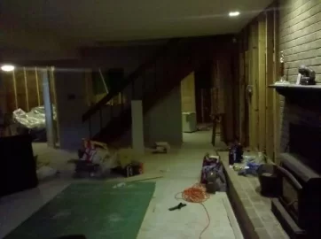

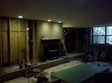

Hi all.
My insert is on the first floor/basement which is about 30-40% underground. The walls are studded and insulated and I am in the process of replacing the paneling with drywall (among other things). This 700-800 sq ft area has an open staircase leading into the main living area. In another post (https://www.hearth.com/talk/threads/77024/) I contemplated using a fan and duct work to pull cold air downstairs and let more hot air rise up the stairwell, but as you work you can’t help getting new ideas.
Check out the pics.

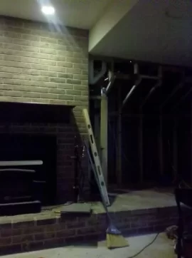

See the soffit directly above and to the right of the stove? Right above the PBR can that the light is magically drawn to. That leads right into the return of the upstairs HVAC system (which is right behind that wall and inside the insulated envelope of the house).
What do you all think about putting a couple of registers into that soffit so the heat can penetrate into the soffit, fill the empty space between the floor and ceiling, and be recycled by the HVAC?
There are code issues with having returns within 10 ft of a stove. Assuming I install a $50 fire damper like this one ((broken link removed)), do you think I am still up to code.
BTW, my chimney is 25ft w/ a 6†SS liner, so I have a great draft and I’m not worried about CO, but I would probably get another CO meter or 2 w/ this configuration just to be safe.
Thanks for your feedback!
There are folks here that have more experience and knowledge about the abilities of recirculating warm air that gathers at the ceiling. But, here is my opinion...I doubt you will experience the results you're hoping for.
That warm air at the basement ceiling will mix with the cooler air from the other return registers when the HVAC fan is running. This mixture will result in an actual air temperature less than the basement ceiling air, and greater than the other return registers.
For example...lets say the air at the basement ceiling is 85°F, and the air from all other return registers in the house averages 70°F. Now, lets assume the HVAC fan will be getting 40% of its air from the basement bulkhead registers that you are proposing, and 60% of its air from the other return registers throughout the house. This mixture will result in an actual mixed air temperature of 76°F { this is determined by -- (85°F * 40%) + (70°F * 60%) = 76°F }. Hardly warm enough to be worth the energy of running the fan. In fact, it will probably feel drafty.
I hope I explained this so it makes sense. I'm sure others will chime in soon.

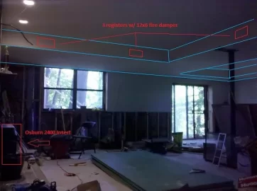

Thanks fdegree. I never thought about it that way, but your analysis makes a lot of sense. I read a lot about recirculating air with the HVAC on the forum and it I recognize it's a mixed bag. I've read that those that have had success are the ones that have the HVAC unit within the envelope of the house, and that's my case.
I wasn't clear in my first post, but actually I never intended to just run the HVAC fan without the heater on. I am hoping that opening the soffit to the hearth room will:
1. Allow some heat to rise up through the HVAC returns;
2. Allow some heat to fill the dead space between the basement ceiling and living room floor; and,
3. Allow some heat into the HVAC room and chase and give the HVAC warmer return air to begin with which I think would improve efficiency when it is running.
My motivation comes from a friend that has a stove in his basement. His basement is unfinished with no insulation but his floor joists are open and the heat makes its way upstairs very nicely. You can see on the new photo below where I would like to put the registers w/ fire dampers. So my questions are:
- do you think this will help move more heat upstairs at all?
- do you think the location of the registers here are sufficient/best?
- do you think including the fire dampers in the registers takes care of that pesky code issue?
I should note that I am not trying to use the insert as our primary heat source. The basement will be a primary living space (when I get done with it!), but the Osburn 2400 has big a 3.2 cu ft firebox so I would like to share a bit more of that heat with the upstairs and cut back on the natural gas bill.
Thanks!
Mike.R

I think I understand what you are trying to accomplish. It may help. Without knowing more about the rest of the HVAC system, it's hard to say for certain. Although, there are more knowledgeable people on this forum, than I...was hoping to hear from them by now.
When the HVAC fan is off, there may be a little migration from the basement ceiling, through the return duct, into the upper floor space. Some of that action may depend on how frequently the HVAC fan cycles on and off. Every time the fan comes on, it will remove that warmer air from the duct, and cool the duct back down a little. Just because it will be pulling the cooler air, from upstairs, through this duct.
I would say the locations are as good as any
I honestly don't know. I'm not too familiar with those codes.
Another thing to consider is how this will change the air flow characteristics within your entire home...especially if this duct work is used for cooling during the summer months. A certain percentage of your overall return air will be drawn from the basement, and the air that is being pulled in through those basement return registers has to come from somewhere...most likely it will be drawn down the stairs from the upper level. During the winter, this may not be a terrible thing. It may pull the air down the stairs in a similar fashion as a fan placed at the top of the stairs, blowing down. But, during the summer, you may be pulling the cooler air, at the floor level of upstairs, down into the basement...that may not be a desirable thing.
Again, without knowing more about the entire system, some of my observation may be way off base.
