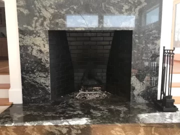

Hi,
I am a new poster but I have been lurking and read a lot of posts here over the past couple months… you folks have a wealth of experience and perspectives and I’ve learned a lot (and still have a lot to learn)! I am hoping you might be able to provide me with some advice.
I live in Southern New Hampshire in a big (3500 sq ft), house built in 2002. Propane bills are very high and I want to bring them down! The house is very well insulated (2x6 construction with gaps filled plus 1-2” insulation board applied on top of that) but the living space has lots of big, beautiful windows. They are well sealed and double insulated but of course their R rating is intrinsically low!
I have a really big masonry fireplace in the middle of the great room which is about 1600 sq ft including living, dining, kitchen with ceilings of 9 to 12 feet (and lots of glass). When I light a fire, it is beautiful and it does a great job of sucking warm air out of the house and out the chimney!
I have 10 acres of forest and chainsaws/axes and a drying shed, so I am all-in to reduce my propane costs with burning wood in an ecologically reasonable way.
I do care about the aesthetics of my solution, though, which, together with the size of my firebox leads to some challenges….
My first thought was a wood burning insert with a blower, but two issues with that: First, the fireplace opening is so big (46.5” wide and 41.5” tall) that I couldn’t find any that even approximated those dimensions; even if I were to put one in and then put a big black steel surround panel, the insert and its glass door are going to look puny and silly compared to the overall fireplace and beautiful granite surround. Second, I really want something that can put out a lot of heat and it seems that inserts don't have large fireboxes and they are not as good at creating heat as woodstoves.
So, based on some posts here, I started thinking about a stove sitting as far as possible back into the brick firebox and extending onto the hearth – a big one like the Lopi Liberty, for example – with a blower and the chimney pipe running straight up through the open/removed damper (surrounded by a sealed plate etc) and maybe a new metal liner up the chimney (bedroom floor above plus high attic under my steeply pitched roof).
However, I don’t want to/can’t extend the beautiful granite hearth, or mess with the beautiful granite surround.
My questions are these:
1. Am I right that there are no big/ tall inserts that would look good in such a tall and wide fireplace opening, and that for maximizing heat I am better off with a stove?
2. If I have a stove partially sitting in my original brick firebox what does that means about rear and side clearances – since the masonry is non-combustible, can I assume I can ignore the clearances there? And what about the front clearance – since the granite hearth is a foot off the floor, do I need the full clearance for the stove in front or does the dropoff reduce or eliminate the front clearance requirement? Or, could I place a hearth mat in front of the (granite) hearth on top of the hardwood floor to get around that?
3. Any recommendations for specific "large firebox" woodstoves that are really solid and well built -- I am willing to pay a premium for something that won't give me trouble?
4. Any other ideas?
Thanks to all the posts, I understand I need to be burning well-seasoned wood and I need to be careful to make sure I clean out the creosote on at least an annual basis to reduce the likelihood of a flue fire.
Some more measurements/specs:
- Firebox is 47.75” wide in front and 23.75” wide in rear; 22.75” deep
- Fireplace opening is 46.5” wide and 41.5” tall
- Hearth is granite set on masonry/poured concrete 20” deep in front of fireplace and 12” above the hardwood floor in front of it
- Fireplace surround is 1.5” granite set on mix of masonry and cementboard
- Firebox has ashdrop in floor down to basement cleanout
- Firebox has external air input in right rear that is connected to a metal pipe going out to side of house to screened vent (about 4-5” diameter – sort of like a dryer vent)
- Current fireplace draws well
Thanks so much for any help!
Anthony

You're on the right path. There's room for a large freestanding stove. It will still need at least ember protection on the floor to protect at least 16" from the glass. This should be semi-permanent at least. A fireplace rug is not the best, but a thin flat hearth pad would work. It should be anchored with at least a couple screws but could be removed in summer. Or perhaps just a flush, copper (or other metal) extension at floor level? Look at stoves in the ~3.0 cu ft range. There are several that would work. Consider how it loads (E/W only or E/W and N/S) and get it with a blower. Note that a blower on back may extend it further out into the room.
How tall is the chimney? It will need a full liner that matches the stove requirements. And the install will need an insulated block-off plate, preferably at the lintel level, to keep heat in the room.

Woodstock makes good stoves, but there is the caveat that none have a blower option. In this circumstance a blower will make a significant difference in convecting the heat. This can help deliver more heat more evenly in a big space, especially when used in conjunction with a ceiling fan.

I was envisioning that the stove would be installed outside the fireplace opening. IMO in that case direct line of site radiant heat would trump convection blowers. In large room there is not normally a lot of need for convection blowers as natural convection starts pretty quick with stove sitting in it. a personal bias is I hate listening to fans.
Wow! Thank you so much for these interesting and helpful replies. It has sent me reading more about BK stoves on the site, Woodstocks, and lots of other threads, etc.
I had been thinking I would tuck the stove into the fireplace as much as I could (since I am constrained on the current depth of the hearth. (Although for heat, bringing it out further is better – I get that—and could at least partially mitigate lack of a blower which is a good point.)
But when I look at the BKs versus the Woodstocks the larger BKs (I like the automatic burn control and even longer burn times and the blower options) seem to only have vent exits from the top and then minimum two foot vertical before turning horizontal into the fireplace.
So, even with my tall fireplace opening, I won’t have enough space for that (and I don’t want to send the pipe in higher on my wall above the fireplace surround and cut into the masonry flue – it would look awkward in my space). Whereas the Woodstock has the rear vent option so I think I could send it horizontal into a cleanout T connection and then a stainless pipe snaked up through the masonry chimney. So, I think I need that rear vent exit. Am I missing something here?

Why not vent straight up with the stove partially in the fireplace? The Liberty is also top vent only. By the first posting mentioning the Liberty as an option it sounds like there is enough room to vent vertically.
The installation instructions on many of the stoves seem to recommend that you create a T-junction with a cleanout, so that was indeed my question: is it ok to just go (more or less) straight up from a top vent through the damper and they chimney and not leave a cleanout. Based on what you replied, I guess a lot of people do just that.... (thanks again for all the help from @begreen and @peakbagger !)

Yes, it's absolutely ok and done. Here is an Englander 30-NC installed this way. The best stoves for this kind of installation have an easily removable baffle or a clear-shot bypass to facilitate easy cleaning.

Welcome Adatel. Can you post a picture of your proposed install location. These guys here really respond to pictures and ALWAYS will catch little things that might be missed otherwise.

What is the depth of the fireplace at around 30" from the fireplace floor? Is this an exterior wall fireplace?
Sorry for the delay - I was out of town: depth is 19 inches at 30” of height; hearth is 24” deep; so I have 43” to edge of hearth at that height. Also, fireplace is not on an exterior wall. It is in between the living and dining rooms with large passageways on both sides.
After everything I have learned here I am thinking about two options:
1. Blaze king Scirocco 30 with legs, fans and maybe external air duct
2. Woodstock Ideal Steel
I am away for 2-3 days at a time often and so the idea of being able to leave the BK running for 30+ hours (using the automatic primary airflow) would probably keep the house above 50 degrees even in winter. I also think the fans will do a better job of keeping the entire big room space warm.
As for the Woodstock, I like the bigger firebox which accommodates longer splits and more wood. I am worried about the lack of fans and I think it will take me more time to learn how to optimize.
Both of them should look good in my space in black. I would consider the BK King but I just can’t handle the pot belly aesthetics.
I need to find somebody to clean the current masonry chimney and then do the install including stainless pipe all the way up.
By the way, I have a propane water heater in the basement that vents into the same chimney... Problem?
The stove will need a full stainless steel liner sized to the stove requirement. It can not share the flue with anything else.
