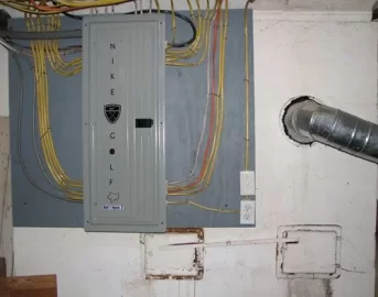

After learning of Englander's add on wood furnace, I think I want to go that direction instead of a wood insert unless there are major reasons not to that I haven't thought of. One problem is that my second flue is sort of blocked off from access by my electrical panel. Are there any options or ways around moving the electrical panel? Some sort of magic way to get into that second flue via the furnace flue? Wishful thinking, probably. ;D

I know! When we rewired the house that was pretty much the only place to put the panel. It might be able to squeeze back into the space where the wall jogs back in from the chimney bump out, but at the time this was done, the old meter was installed there and still hooked up. So I'm screwed, huh?
Not good, even if it could be moved a little, the panel need to be a set distance from the furnace. I don't know the code offhand, but suspect it's at least 36"?
The current furnace could possibly be forced-drafted which would free up it's flue, but you still would need to keep the new wood furnace away from the panel by the code required distance. Well, you still can go with the insert, so all's not lost.
Is the 36" (assuming that is what is code for me) from the wood stove/furnace or the pipe into the flue? Also, what does "forced drafted" mean?
I'm not a code expert here, would have to look that up. But the intent is to have nothing near the panel that would interfere with access or servicing. Will try later to look up the explicit code. Forced draft means that the exhaust from the furnace is connected to a hi-temp blower and it is exhausted out the side of the building.

Assuming you have 220v in your panel - you must have 3.5ft from the face of your panel to any possibly grounded equipment.
If you want to look it up its article 110.26 in the 2005 NEC book.

I measured and I have just over 7' between the edge of the electric panel and the edge of my oil furnace to the right in the picture, so getting a wood furnace in there should be ok. My oil furnace is a Thermopride and according to the manual, it can be power vented and Thermopride sells their own kit for it. I'll have to talk to my oil guy that installed this last year and see what if it is possible to change the venting and how much it would be.
