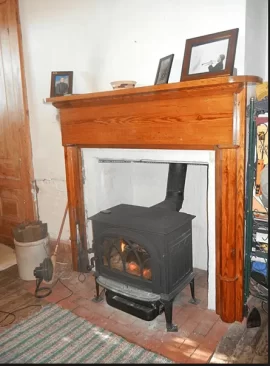

Like that?
You're going to have more issues with clearances, both height of stove fitting, distance to mantel and hearth in front of the stove. It's tough and will take awhile to find the right stove and may still need some re-construction.
Best bet is to find a rear exit chimney stove.
