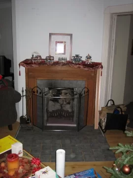

Last spring my wife and I bought an old house built in 1892 that has been gutted and refinished. It has an old coal burning fireplace that isn't safe to have open fires in. I would like to put something in there that we could get some heat out of. The house is around 2000 square feet, however, we wouldn't need something that would heat the whole house. The problem I'm running into is the size of the firebox and the hearth (see attached pics). I have already extended the hearth by 6 inches by ripping the floor out and putting in durock with an extra tile width so I would like to avoid having to do it again. I could have a mason modify the firebox to give us extra room for an insert (is that a safe thing to do?). I was also told by a local stove dealer that I can't stick a stove into the firebox because it has to have clearance overhead. Is that true? If that is the case then if I were to put a wood stove in there it would have to sit fully on the hearth which means I would have to extend the hearth out yet again. Plus it would stick out into the room quite a bit.
If we can modify the firebox I was looking at either the regency I1100, or the Lopi Answer. If we can do a wood stove I was looking at the VC Aspen, Jøtul 602CB, or Jøtul Nordic QT.
Firebox dimensions: W = 23.75", H = 30", D = 15", Rear width = 18". Hearth: W = 59.5", D (to firebox opening face) = 23.5"
Any suggestions or recommendations would be great.
P.S. It's an unlined chimney that I'm going to reline with an insulated flexible liner and is about 30' tall. Thanks!

An insert will fit better, a wood stove would heat better
Hate to say it but the best bet might be to extend the hearth again and get a big stove. In that climate you need at least a 2.5 cubic foot firebox
I'm with Bab to use a hearth stove - because that is quite a small fireplace and anything that fits back in there would have to be quite small.
This will require the hearth to be extended, but you can look for a stove with relatively close rear clearances.
It looks like the fireplace may be interior - if that is true, then a stove or insert sitting back into it would still be a good option (not as good if exterior)..... Since you don't care about heating the entire house, some of the models you mentioned may be A-OK. How about the Jotul 3CB? That thing can pump out some heat and will look good in a house like yours. It should fit OK, and you can even use short legs (I think) if you want a bit more top clearance.
2000 sq ft of 1892 house in Minnesota will need two 3CB's ;)
If its a Jotul it needs to be the Oslo, no?
EDIT
Ooops got the Jotuls confused. Better be the Firelight CB, thats the big one
Another option as far as hearth stoves is woodstock. Their stoves are side loaders so the clearance to the front is only 8". But then you need 16" on the side.

It sounds like extending out the hearth further yet and putting in a stove would be my best bet. If I extend the hearth more I suppose I could go with something that would really throw out the heat like the Jotul Oslo or Firelight. Is it possible to put a smaller wood stove part way in the firebox and part on the hearth or does it need more then a couple inches clearance on top?
That sucks, I wish I would have known that I needed even more hearth space when I extended it the first time that way I could have done it all at once!
Any more suggestions would be great. Thanks again.

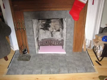

It sounds like I will be extending the hearth out even further. Do you think 1/2 inch Durock with 1/4 inch thinset and 1/4 tile would be enough floor protection?
Can I also put the rear part of the stove where the exhaust pipe comes out part way into the fireplace? Thanks for the advice.
Floor protection is dependent on the stove model, what is the current floor protection there?
Manufacturers will tell you and R value, some tell a K value as well. MICORE is a really good material for heat protection but it is flimsy so it would need to be incorporated with a durock/cement board
Northern Living. The Answer and I1100 are small stoves. A bigger stove is likely warranted. How large is the room that the stove is going in? How open is the 1st floor plan? How will you be running the stove- 24/7 or evenings and weekends?

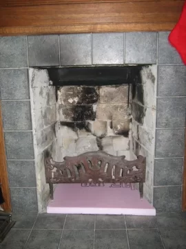

Regarding the clearance question, is there a mantle currently on the fireplace? The photo doesn't show this.
As to floor protection, it will depend on the stove choice. Most Jotuls with the bottom ashpan and heat shield simply require ember protection. In that case, 1/2 inch Durock with 1/4 inch thinset and 1/4 tile is enough floor protection.
The room the stove will be in is 12' by 22'. It's a very open first floor plan. The stairs going up are right around the corner from the fireplace are rather open. I think I would get a fair amount of heat going upstairs from the stove.
Here is another picture with four more tile widths laid out for comparison along with a pic of the mantle. The mantle only sticks out from the wall 2 inches at the very top and is 47" from the hearth.

The Oslo is a great stove and a good looker too. I agree that this sounds like a good setup for the bigger stove to do a good job of heating more than just the room. The Jotul F500 Oslo does have a side door so it would be best to do a masking tape outline of the stove on the hearth and determine where 16" falls from the side door as well.
The woodwork is an issue, even if only 2" it is combustible and directly over the hottest part of the stove. Some sort of shielding will be needed. See the Oslo manual for an explanation of what is required and clearances needed.
