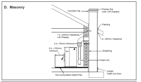

Depends on the stove you buy and the venting diagrams that come with the particular make and model you purchase. Some allow for venting into a clay liner and others require a 3 or 4" flex liner etc. all the way up. As far as what is acceptable in the house, anything inside the house has to be double wall pellet vent ( including T's,cleanouts, elbows and adapters) and pellet vent is under a slight pressure, wood stove venting is not. Where applicable you could adapt at the thimble out to 8".

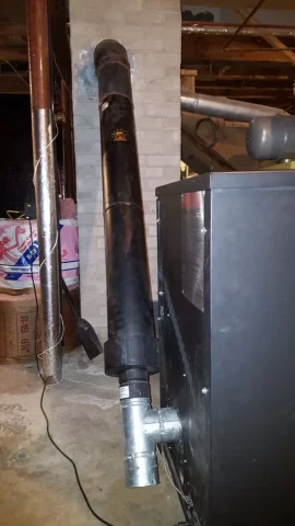

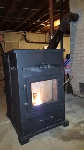

I have no problems with CO detectors or any odors at all with this install. It drafts just fine, though not as intensely as the wood stove the same principal applies. Instead of 300 to 500 degrees drafting it's 150 to 170 degrees. I sweep the 40' chimney every spring and get about 1 to 2 coffee cans of powder at the clean out, no creosote build up at all. It's the same consistency as what is in the firebox. And yes check with your town/city install codes. My inspector was fine with this install.

Thanks for taking pics of your setup. I would be interested in doing something like that but with more pellet stove pipe versus the wood stove piping
