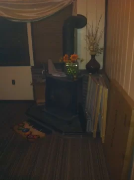

So this stove is not in used at all.
I would like to put another stove in this spot tho. What you see is the black pipe going into cement block chimney and the inside liner itself is clay and it goes straight up about 15-18 feet.
This is my question what type of chimney do i buy to run inside that chimeny, flex, rigid, class a? All the flex pipe i see install into a insert. I never saw class a in a chimney. So if i use flex pipe is their a right angle adapter to connect to the balck pipe? Id like to run thid inside the existing chimney if possible so i domt have 2 stainless steel cylinders outside my house.

How do you guys think this should be done. 6 inch pipe is what i would have to use.
you would get a liner there are several options for liners you can get different thicknesses of flex liners light wall smooth interior light wall mid weight and heavy wall flex. For wood we always use either mid weight or heavy wall but regular light wall will work ok it just is not as durable. Do not get the smooth interior light wall it is junk. Then there is rigid which is very durable but I find it kind of a pain to install personally. Then you have the insulation options you can get preinsulated you can wrap it with insulation or you can use pour in. But doing pour in correctly takes some skill

Yea but when i get to the black pipe how do i connect it? Do they have a T that i can use on a flex pipe? So i can then run my double wall black pipe to it?

Yes absolutely it is a 2 part tee. You have a tee body that has a small flange on it that gets attached to the liner then dropped down the chimney. Then there is a snout that slides around that and a clamp tightens it down.

Thanks begreen amd bholler. I knew i missing something. Cause I was lookig for flex liners and didnt see a 2 part T amd the yoitube videos i saw everyone was connecting too a insert.
