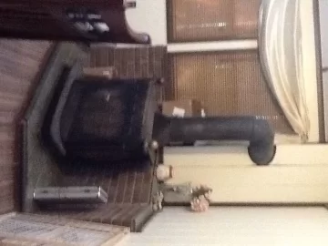

Ok so i might be putting a balze king princess in this spot. Using the same black pipe but with a adapter. The black pipe goes into the chimney with its own dedicated flu so nothing is sharing it. Dont have the money for the class A chimney yet but next year in the spring ill be running that straight up and threw the roof.
for this winter would i loose all the performance on the princess just running it direct into the chimney? Chimney is clean as i clean it every year.

That should be a nice improvement. The hearth will need expansion of course and I have to say that wall thimble looks suspect. What material is the pipe passing through and how close is it to the window frame?
Yes i have tile for the hearth expansion. The material around the (maybe some type of wood paneling) black pipe not really sure but i will be taking that off for sure, Behind it is the cement block for the chimney. Window distance is 20 inches And ceiling is like 4 feet. Im just curious as this setup is not the new standard. Wiithout class A pipe will the stove lose any burn time or any negative effect on the stove?
There are two important aspects to a good installation, safety and performance. Single-wall connector pipe needs to have 18" clearance from combustibles. The wood paneling represents a hazard due to it's proximity to the hot stove pipe. The chimney could also present a safety hazard depending on its construction and condition. Is it tile lined? If yes, do you know the inside dimension of the flue tile? How tall is the chimney.

If i do a liner and run it down the chimney how do i connect it to the black pipe, all the liners i have seen connect direct to the stove themselves. its a single wall black pipe and i should of stated it will be replaced with double wall.
The stove is a 2 year old blave kin princess parlor that im buying for 1600 bucks.
My chimney is clay lined and im not sure of the dimensions yet(but will get, if i had to guess its 8x6)when i cleaned it this year i saw no sines of cracks. The chimney height is 15ft tall and pretty awesome shape as the stove thats thier now was rarley used compared for its age.
So by not putting a liner in or using a class A am i going to kill my burn times? I know its hard to judge and to give a accurate decision. Im just looking for opinions for those that maybe have installed a stove and used a existing clue lined chimney.

for this winter would i loose all the performance on the princess just running it direct into the chimney? Chimney is clean as i clean it every year. Yes you will loose a lot of efficiency if you do it like your picture shows on its side. They go vertical up and down.
The liner terminates at the thimble level with a bottom-capped tee with no snout. The snout is put on thru the thimble hole. The stove pipe joins to the snout.
