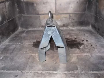

I purchased a pulling cone and it was a waste. My flue size is the same as yours and the cone, which is slightly oversized, wouldn't fit. My solution was what's in this picture. It's a section of stainless steel track for steel wall stud systems and an I bolt. These were pieces I had laying around the house, so it was free. It would cost less than $10 to make though. I formed the track to fit inside the liner and attached it with sheet metal screws. Took me less than 5 minutes to pull my liner down once I started. Had a friend in the basement pulling and I while I fed the liner down the chimney.

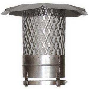

Oh and any comments about which rain cap to use?
Standard:
[Hearth.com] installing a chimney liner... ?
Deluxe:
The delux looks like it includes the top plate as well, but net is still a $40 increase. I'm not really sure what advantage it has over the standard?
