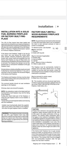

Would it be better if we installed a Majestic ruby series insert in the Majestic MBU 36? From the ruby series installation manual.
"For Installation into a Zero Clearance Wood burning fireplace: • The brick (refractory), glass doors, screen rails, screen mesh and log grates can be removed from a factory built firebox in order to gain minimum gas insert opening requirements. • Any smoke shelves, shields and baffles may be removed from the factory built firebox if attached with mechanical fasteners."
We would have a Majestic insert in an Majestic fireplace.
