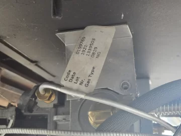

Good afternoon all,
I am still new to the forums, although last year I did come online looking for help replacing the wood burning stove in the log cabin home we bought in Colorado last August. Thanks to a lot of help from this forum, I ended up buying a Drolet Legend III stove, and it is working fabulously!
However, we have a very large log cabin, at 3,100 square feet, and the one stove is not quite enough to keep everyone comfy all night. Our primary bedroom is on the main floor, on the opposite end of the house from the wood stove. We have 240V baseboard electric heaters in the bedroom, but holy moly are those expensive to run! Our power bills were north of $400 / mos throughout the winter, and that was only running the baseboard heaters at night! So, I have decided to install direct vent propane heaters in the bedrooms, as well as the basement.
I was able to purchase a Jotul GF 300 DV natural gas stove, which appears to be in great condition, for a great price of $250. But, we don't have NG, we have propane, which means at a minimum I need to install a conversion kit. The most difficult part so far was identifying the exact model and S/N of the stove, as the identification tag was removed at some point. I spent quite a bit of time on the Jotul website, and downloaded several manuals. I am about 95% sure that I have GF 300 DV, based on the dimensions of the stove itself, as well as the orientation of the exhaust collar.
So, this is where I am going to ask the forum for help... I am going through Rocky Mountain Stove Supply for parts, (as they are relatively local to me). I have ordered an NG to LP conversion kit, as well as some of the replacement ember material. What I am hoping for is any recommendations from the forum on what else I should do to recondition this stove? I am going to touch it up with stove bright paint. I am wondering if I should replace the gasket on the glass? The existing gasket LOOKS good... but I am wondering if I should consider anything to do? For instance, should I replace the gas logs?
Lastly, I will be installing this myself... I am running the propane lines, and will be cutting a hole in the log cabin wall for the vent. Any suggestions on the best way to do that? I am thinking the easiest way is to use a large hole-saw.
I have attached some photos of the stove (I have the top and the doors, I just took them off for ease of moving the stove.)
Once I get this heater in the primary bedroom, I will tackle a GF 600 DV II in the basement, which I was able to pick up for $400. It is in even better shape and is already set for propane.
Thanks in advance for any suggestions!

Congrats on the new unit! I have always been a fan of Jotul products. You didn’t post any interior firebox pics. Does it have a tube burner or a pan burner? That can help to narrow down the age of this baby, & purchasing a back up burner might be desirable. Burning LP tends to be pretty destructive & I’ve seen many Jotuls with compromised burners of both types. If you have the installation manual, I believe you might find that this unit requires a minimum of a two foot vertical rise before a horizontal run. Also, take a look at the wall thimble for the vent penetration. IIRC, a round hole will not suffice. I’m pretty sure you need to cut a 9”x 9” or a 10” x 10” opening for the thimble to maintain the Clearance to Combustibles (CTC) for the venting. I would replace the glass gasket. It should be 3/4” tape gasket & readily available. You may want purchase a replacement log set, if one is available. As time passes, Jotul may obsolete what you need & you’ll never be able to get one.
Hope this helps…
Reactions: Cyxelsid
This should have the pan style burner. It was the major shortcoming of this model stove. It has a cast base with a stainless top that is pressed together with a gasket that is notorious for blowing out.
Reactions: Cyxelsid
Sounds like you got a great deal, the GF300 DV was a very popular stove. Gas valve on the side means this stove is about 12-15 years old. Probably first gen of the flat pan burner, which others have said their opinions, but its a great unit. Parts are still available but as DAKSY said, to have a spare is always nice. When you get it running, you'll see if burner is compromised, flames will come out from under the edges of the burner. I'd get the blower kit too, if you can, it hooks into the molex connector for installation. She looks to be in good shape, with a fresh paint job, she'll look like new. Good luck with her and espec the Firelight you mentioned, that sounds like a deal too. Stay warm, gonna be near 80 today in SE CT, but change is coming.
Thanks for the input! I got it converted to LP yesterday, going to paint it today. Need to order the vent pipe.
