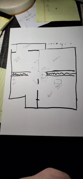

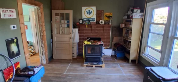

1000+ square foot house / basically 4 rooms + small kitchen / see diagram. New stove has been setting in front room for 2 years lol.. Never installed - it is a US 2000E? stove / for you guessed it / a lot of square feet lol.. When I went looking at tractor supply for the 1000 - 1200 ft version - the 2000E came home.. At that time, I didn't like the size size of the firebox (the 1200? ) ..No I didn't ask a lot of questions before buying, / etc.. It just happened.. I originally bought the triple wall duraplus stuff / logged on here - and ended taking the stuff back lol.. Stove has been sitting since :(

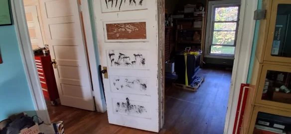

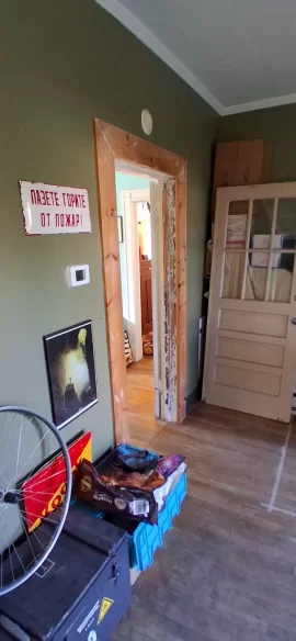

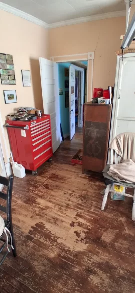

If you look at pics - you can the the 100 yr old house is basically a square / rectangle cut in four squares / with a small kitchen in very back.. My room is behind the fireplace mantel wall / a thick wall .. ** One key note in picture of front room is the where the white door is sitting next to the stove - that was a walk throu - they dry walled the front - the backside was never finished. I am going to open it back up the a door.. Make a dutch door..
Ceiling are 9+ feet high. Going to put some vents high on walls / to help the temp loop thing etc..

Without some convection help, the stove will overheat the room except for the coldest days. If a convection loop is established, then a smaller 4-5 split fire should be ok. Note that the Jotuls and Morsoes are mostly cast iron, radiant heaters with larger clearance requirements. Something like the PE Alderlea T4 or the Blaze King Ashford 20 is a good compromise. They have a cast iron jacket but are steel stoves at heart. The clearances are lower and the heat much softer which is better for small rooms.
To circulate the heat, pull off the doors separating the rooms (except maybe the bedroom). Then, put a table or box fan in the tv room, on the floor, pointed towards the stove room. Run the fan on low speed to keep it quiet.

As for doors - if using I ANY stove I will just keep them open... Do plan on adding a few vents UP HIGH on walls - maybe even above the doors.. Would that help at all?? Doors being open..
Not too much, a ceiling fan would do more. The fan suggestion I mentioned works well. A fan can move more cool air than hot air, it's denser.
Question: How will the stove be vented? This is a top-vented stove. Is a new chimney system being put in?
Top... Approx 6.5 ft to ceiling / 48" (4 ft) attic / 3+ ft to roof ridge line / +2 ft ! Need to recheck the roof measurements. That makes it 15+ feet. I think I was shooting for 16+ ft.
