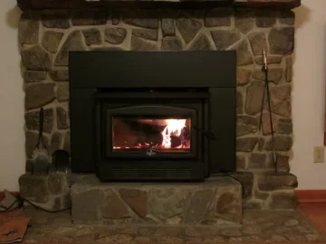

If your hearth only extends 6 inches from the fireplace, you'll need to add and extension. But I'm guessing you have a similar situation that I have....you hearth goes to floor level beyond the 6 inches. I only had 4 inches extending from the fireplace. I ended up adding a small extension you can see in the attached picture. When I purchased the house the original stove just had some concrete blocks (like these http://www.homedepot.com/p/Paveston...Impressions-Concrete-Wall-Cap-86835/100540616) under the front of it.
  • [Hearth.com] Installing a insert with blower when in have no hearth extension?
https://www.dropbox.com/s/2mpd9c2867lbnxg/DSC_0175.JPG?dl=0
