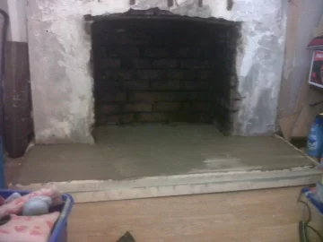

thanks guys this fire will not be used as an open fire in the future so i can use normal brick with sand and cement mix,ok what are the clearances from the sides and rear of the stove as the materials are non combustible, and yes i am from south wales uk many thanks again for your replies below is a pic of the opening above the 2 rows of bricks there is a metal lintel with a brick arch above so i will be removing the 2 rows and will put a concrete lintel there which will be sitting on a row of bricks either side closing the opening roughly 9 inches leaving 27 inch wide and 27 inches tall 14 inches deep is this ok so far.

The stove manual should state clearances.
Understand that you will never use it for a fireplace but what about the family that buys the hous in 50 years?
Cool looking chimney - what is the rest of the house like? :)
hello mfglikman the problem is i have not chose a stove yet looking up on dimensions ,haha i have lived in this house for 20 years this was blocked up when i moved in the rest of the house is fine, this is my dining room (shes going mad) i understand what your saying about someone else owning the house in 50 years so i will do my best to pass on the info if i sell cos i aint counting on dying yet anyway cheers
I'd LOVE to see that fireplace in it's heyday, I bet it was a cozy place! If that were MY fireplace, I'd be cleaning off that whitewash parge and repointing all those bricks......then a good sealer (like Siloxane) to keep it clean and pretty..
A little catylitic stove would look great in there and really put out some heat, much more than an old open fireplace. I'd be considering installing an insulated liner for safety and performance reasons. Keep us posted with progress and pics, I love a good install project.....(check out mine on the link in my signature below).

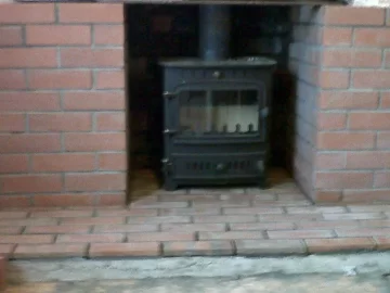

just an update on the fire place it seems to be taking ages but we will get there
  • [Hearth.com] installing a new fire
Cute, that looks great. When do you get to fire it up?

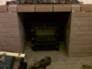

[Hearth.com] installing a new fire[Hearth.com] installing a new fire

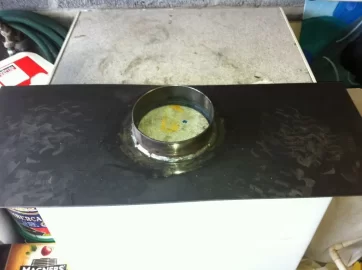

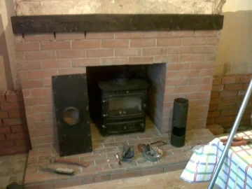

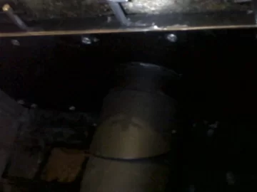

as soon as i have the liner fitted got to get a hetas qualified person to do it, regs hey.below is the register plate i made and the first course of bricks sitting on the angle iron their not cemented in yet though,now to get a piece of oak 5x4 inches by 6ft long,im a little lost on a fender around the hearth its 67 inches by 17 inches any help would be nice thanks

Hi Dean,
I would get some slightly oversize firerope and pack it in there, very easy to do, cheap and easy to remove if ever you have to.
Also pack it round the flue pipe/register plate gap.
hope this helps
Billy.

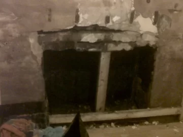

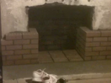

[Hearth.com] installing a new fire ok in the picture there are alcoves either side of firebreast walls where i have bricked should i come flush with the breast wall or not cheers

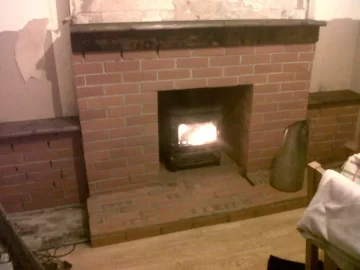

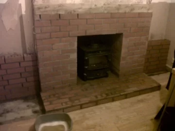

well its coming on nicely now any ideas for deco above mantle, stone do you think
Looks good Dean. Stone veneer might work well above the mantel. Maybe a nice large mirror Trimmed out in nice woodwork. All depends on you & the lil woman's preferences. Many things can be done there.
I would just tidy up the plasterwork and paper/paint it, think you can over do it.
