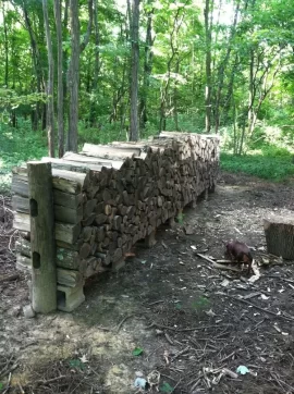

I can't wait for my first fire. Thankfully I cut and split about a cord and half of ash this summer thinking I would burn it in my open fireplace. Freshly split faces are measuring 8-14% moisture content. Woodpile pic was taken when I was half done stacking.

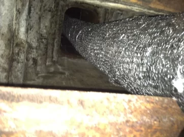

The special sawzall blade worked o.k. I did not get the install completed today because my liner does not fit the adapter I have. I did get the liner down the chimney and the top plate and rain cap installed. Here is a pic of it coming through the flue tiles and into the smoke chamber.

I think it's better to work up the bottom connection before you finish off your top connection so you have some extra liner to work with in case your fit down below comes out a bit short. Once you have the bottom connected you can go back on the roof and then cut off any excess liner without worrying about coming up short. Since you said you couldn't finish the bottom due to the liner not fitting your adapter you could still go up on the roof and shove some of the excess liner you have hanging down inside your fireplace back up the chimney (pull it up from the top) and temporarily lock it in place with the band clamp on the cap connector. Then when you get the parts you need for finishing the connection to your insert you can fine tune your liner and then cut off the excess on the roof and finish the top connection. When I did my liner I found that by connecting the ss flex liner at the bottom I was able to pull a bit of slack out from the top as I tightened the top clamp and that straightened out the flex liner so that it wasn't touching the sides of my chimney clay tile flue.
