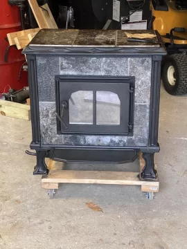

Nice looking stove, while ordering the liner, insulation, chimney cap, anchor plate and flue connector, order a stove door gasket so you can start fresh.

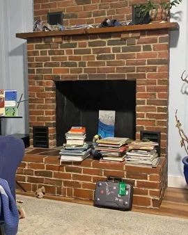

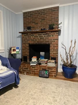

Thanks for the pictures. That looks like it might be a heatform style fireplace which has been painted black inside. I've lightened it up a bit to make it easier to see.
[Hearth.com] Installing a wood stove through a chimney
The stove looks like it's a Hearthstone HII which takes a 6" flue and requires a 6"insulated stainless liner. The lack of damper for this installation is not an issue. The fitting of the insulated liner is. What is the ID of the existing chimney pipe?
What is the size of the fireplace opening?
