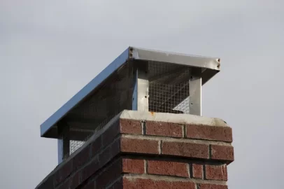

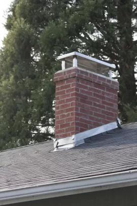

3) I've uploaded some photos. The chimney rain cover has some pins(?) securing it, what's the easiest way of removing them?

3 it s hard to tell from the pic of the chimney cap but it should not be to hard to take off.
