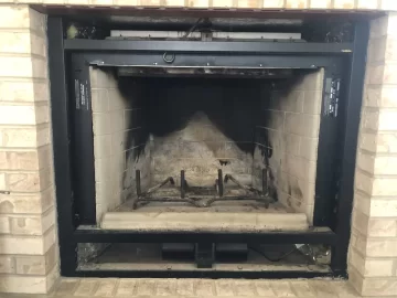

So this is the heatilator. I’ve started removing the trim to see what I have going here. If I remove it I am left with an opening that is all tin with insulation on it. So basically I am wondering if I can turn it into more of a masonry fire place that would accept the sirroco insert. Line the whole interior with fire brick and pull a 6” liner down the existing flue pipe.

This needs to be established with the installation manual for the Heatilator. What is the model number?

The heatilator model is a36c but I would like to remove it to make room for a blaze king sirocco 25. That why I was wondering if it would be possible to remove this fireplace and replace it with the sirocco some way.
You absolutely cannot do this. An insert need to go into a functional wood burning fireplace. Some cement board and fire brick certainly isn't enough

Yes, this is a no-go.

There are some past threads on removing the ZC fireplace entirely and then, if the chase is wide enough, installing a new class A chimney system, and converting the chased area to an alcove. This would require trading in the insert for a freestanding stove.
If this is the plan, the width of the chase and ceiling height are critical for meeting the stove's alcove clearance requirements.
