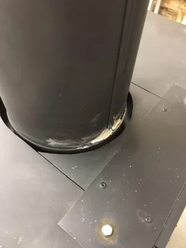

  • [Hearth.com] Installing new single wall, adapter needed?
Reactions: ShawnLiNY
You can use a squeeze tube of furnace cement. Run a bead around inside of flue collar install pipe run a small bead around top of collar and pipe secure your 3 screws than wipe any excess that squeezes out
