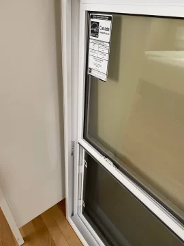

I am going to be replacing 3 windows myself soon. I did the measuring myself, and ordered from a local company that makes them.
These are "inserts" ie I will be removing the existing panes and using the existing window frames. This is the easiest way to do it.
If you are a pro, then you would probably cut out the old window and remove it.
I can barely move the big ones as they are heavy and wide. I hope I have the strength to set them in place.
If you have done this before let me know how it went. Thanks
The big ones are about 40x45" - 460CAD ea
The small one is about 28x37 - 340CAD ea
All single Hung. Energy Star.
