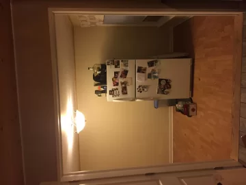

thecurrent floor construction is like pergo flooring i believe, I would be putting a hearth down under the stove. the length of the room is 11 feet and the width of the room is 7 feet 9 inches. I attached a picture of the breezeway looking into it from the kitchen.. Don't mind the fridge because that isn't normally there. The stove would either go along that long wall or in the right corner next to the window. I would love the look of the corner better but if I have to do it in the midldle, then thats what I have to do.

On the straight wall the hearth will project about 50" into the room if double-wall connector pipe is used. That allows a 3'7" passage area past the hearth edge. Locating it where the refrig is and parallel to the wall will take advantage of the additional depth of the large entryway. I think that is how I would orient it, maybe a foot off the window wall. That way if you want to add a blower it will blow directly thru that entrance.
which my wife and I don't mind, that still leaves you with room to pass by. But with the corner install, there would be way more passage area, I just wouldn't be able to use side door which isn't terrible. So it would be okay to have the stove near the window as long as it has a clearance of 9 inches?
