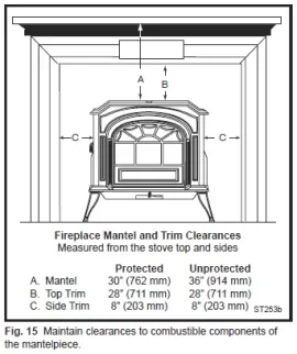

I've got a used Vermont Castings Resolute Aclaim my wife wants me to install in the (partially) inside the fireplace. I can run a 45 degree elbow and pipe into the flue and seal it off with a register plate.
We want to push it back into the fireplace to reduce the front clearance requirements and install a heat plate on the mantle above. Our house is only 5 years old so the chimney is in great shape.
Can this be done? Is this a safe solution? I am worried about all the heat being generated with part of the stove being inside the fireplace.

Mike,
What clearances did you have to the bottom of the mantle and in front of the stove? Did you install with top flue or back flue?
I will have 6" in in front of the stove when installed and 16" above the stove to the mantle trim (I plan on installing a heat shield). Is this workable or am I playing with fire???
