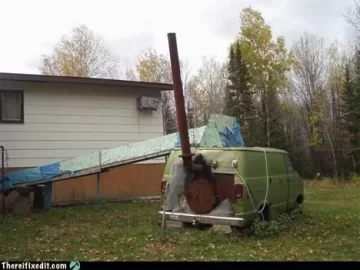

Well, can't say it hasn't been tried.
[Hearth.com] Installing wood furnace in cargo trailer
Reactions: bodhran
Prolly lasted the season, but it looks like leaks were an issue. Fact is that it probably would be only a day's worth of work saved to put it outdoors than in. And then you have materials that may be unnecessary for the in house install. Plus it is not going to work during an outage.
