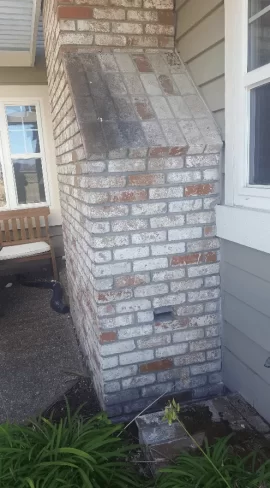

I have a 1980s zero clearance FMI which won't fit an insert. My plan is to remove this factory fireplace, create an insulated box (How is a question) and install an Ideal Steel. The fireplace facade is single layer brick and removing and restoring is beyond my budget, so I'll be using a drill, saw saw and other tools I can borrow to take it out fragment by fragment, piece by piece. This fireplace chimney is not masonary, behind the steel firebox will probably be wood and insulation, so I won't be using a blow torch to alleviate any forum fears. The hearth is 4 bricks raised, firebox is hollow undernearth so will need to build up a new large insulated firebox to fit the stove which will sit roughly 2/3rds in 1/3rd out of firebox.
I've spent the last few weeks wall to wall youtube learning, in preparation for the 'big job'. (and this forum of course). Fortunately I have a friend (He's a heating engineer) who has cut out a zero clearance before), he's lending me his tools and though not a chimney expert himself is a great resource. He doesn't know it yet but he'll be helping me on the roof to install a new chimney liner - after helping me remove the old one). If I figure out how to add photos I will. I Photoshopped an IS and a US stove 3000. US stove required 26" front clearance to combustible floor, I have 16" hence Ideal Steel. If I go with an ash pan on the IS I'll need to remove 2 rows of hearth bricks for head clearance. Sooo... Has anyone had experience doing something like this? I'm on a vertical learning curve here. Am I mad?
Sent from my SM-G920T1 using Tapatalk
Ok I see how to add pics... First is how it looks today. 2nd pic is with a US Stove 3000 with 2 rows of bricks removed from hearth. The 3rd is with Ideal Steel, with current hearth height and quite forward so looks big. Should lower hearth really, then I can have ash pan. [Hearth.com] Installing wood stove in old ZC space[Hearth.com] Installing wood stove in old ZC space[Hearth.com] Installing wood stove in old ZC space[Hearth.com] Installing wood stove in old ZC space

I am going to start a new thread for you. We didn't know this was a Zero Clearance fireplace. The clearance constraints for installing a freestanding stove will work for the proposed installation. Look at alcove requirements for the stoves you are interested in. You might be better off installing a modern EPA ZC fireplace if the intent is to retain the current brick facade. Is there good access from the rear for the removal of the current fireplace?
Thanks for creating the new thread begreen. There is actually very good access from the back. The bricks are a facade and single layer. I was originally looking at Insert. My goal is to significantly reduce heating bills on 2800 sf and a unit EPA below 2 grams per hour. The only inserts I found fitting this criteria (eg Large Flush Hybrid-Fyre was no.1) were $4k+ and I heard that freestanding stoves give off more heat, whilst the inserts require a fan and I think they are generally noisy. Here's the wall at the back. looking at the flue picture again, maybe the flue is 6". Regarding removing the current fireplace from the back, do you think this would be easier?
[/ATTACH] [Hearth.com] Installing wood stove in old ZC space [Hearth.com] Installing wood stove in old ZC space [Hearth.com] Installing wood stove in old ZC space [Hearth.com] Installing wood stove in old ZC space
Unfortunately an insert is not an option for installing into this fireplace. It might be replaceable with an modern EPA ZC fireplace, but fitting it from the rear while maintaining proper fitment to the existing structure could be challenging.
I will not be suprised to hear your 4 brick hearth height is a veneer on a plywood box. That is to say you might pull one layer of brick off the hearth surface and be looking at a plywood box .
