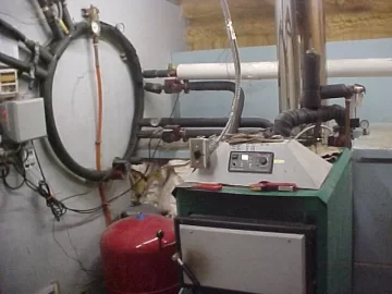

If you do decide to insulate, be sure to buy the correct insulation. Inexpensive "home store" foam may not stand up to the temperatures of a hydronic system. It's fine for hot and cold water piping, but not so for HW hydronic.
I buy the split product from Armacell called Armaflex Microban. Slide it over the pipe, pull the paper from the self adhesive and squeeze it together.
It is soft and flexible enough to do curves and fittings.
hr
Nice! I've been waiting for you to post that circular P/S arrangement here. I'm sure you'll get some questions about that. :)
