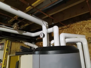

Just thought I'd post some great results on what most of us already know. I'm not a big proponent of insulating hot water pipes in a boiler room unless it's way too hot and heat is just being wasted. This, however, has proven to be very worth while.
Before insulating the 1" copper (all 6 connections) from the top of the indirect I observed about 1 degree drop/hr of internal water temp. Now it's less than half of that.
I should note that the 1deg/hr is with some of the cheapo black foam from Lowes in an effort to keep the heat in the tank, I never measured it before that.
This is 1" commercial fiberglass from a jobsite. Very easy to work with, and with a bit of time you can make it look really nice.

When I had my new boiler installed this past fall I actually started insulating the heat/hot water piping in my unfinished, unheated basement. I bought several six foot section of the black foam. It wasn't cheap and I eneded up not doing all of the pipes. I had my rim joists spray foamed in December. Now I'm thinking that I won't bother with insulating the pipes at all. I think if I do anything else in the basement my money would be best spent insulating the walls down to the frost line. I'm guessing that would signiifcantly increase the ambient tempertaure in the basement.
I have some left over fiberglass insulation from work as well. I have a few peices that are missing the white paper covering. That wrapping is actually reflective on the inside and does more than you would expect! I can physically feel a little heat on the fiberglass peices with no wrapping, but the rest of it feels room temperature with 175*F water inside the pipes.
I got some 1/2" thick foam insulation for the rest and that stuff always feels 90-100*F surface temp. Big difference in quality of R factor.
