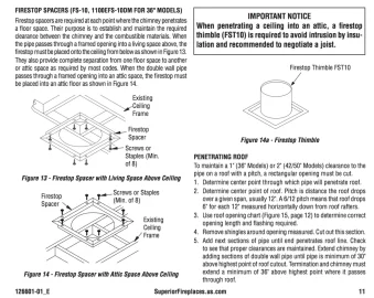

There needs to be a fireblock in the chase at the room ceiling height. Not sure why you added the plywood, but it sounds like there are still issues here.
There is a fire block at ceiling height but how does the double wall pipe get air between the pipes if there is a fire block there
Previously the inside of the chase had plywood on 3 sides. The 4th side had batt insulation exposed to the chimney pipe.
Now there is now plywood on all 4 sides of the inside of the chase. Now the batt insulation is NOT exposed to the chimney pipe.

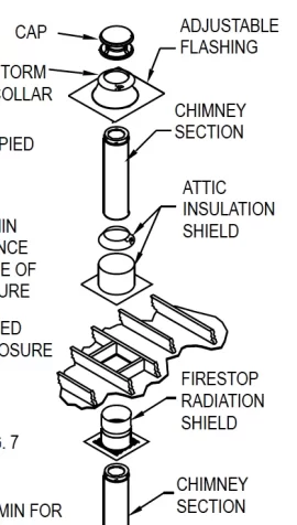

Good question. By double-wall pipe I'm guessing you mean chimney pipe. At the ceiling height a fire-stop radiation shield is installed with an attic insulation shield on top.
