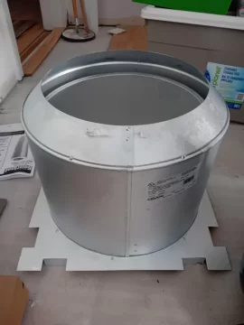

Must you use a metal insulation protection device provided by the Big Corps to pass WETT cert. or can you make your own. The one that comes with the kit only about 20" high and I want it to be much higher. in fact I want it to reach the roof (36") (3-12 pitch) so that I can blow in as much insulation as possible. Can I cut the hole in the ceiling and build my own box out of OSB staying 4" away from the Class A pipe (7" pipe. 11-1/8 OD)
