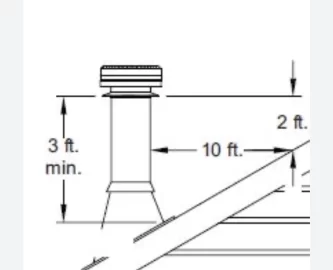

1. The chimney reaches high enough - 2ft above the highest thing within 10ft horizontally.
2. Seal the roof penetration flashing properly.
3. Brace the ceiling support box adequately.
4. Keep all combustibles at least 2" away.
Class A also has to extend a MINIMUM of 3 feet out of the roof before the 2’ higher than anything within 10’ rule applies…

It sounds like you have a good grasp on the rules, this image helped when I did /checked mine. Also make sure meet the minimum flue length recommended by the stove manufacturer/model.

Thanks. Yeah the 2ft above anything within 10ft will easily make the 3ft thing moot.
