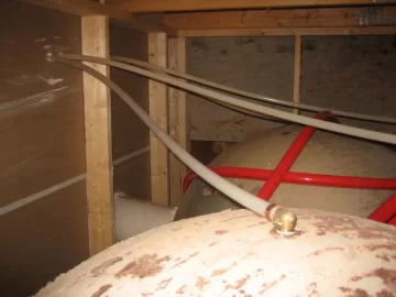

My tanks are in a uninsulated polebarn. I have them standing on end and I made the walls 14" from the farthest edge of the tanks so in the corners there is about 30"s of insulation. I used dense packed cellous to insulate them and I'm pretty happy with the results. I have about 3 ft of dense pack cellous on top of the tanks and then I placed almost 4 ft of Styrofoam balls (used for block wall fill) on top of that. I do not have any frost or snow melt above the tanks on the roof. It was a very messy job blowing in the insulation down 12 feet while climbing on the 4 tanks but it was allot cheaper to do it this way. The big advantage to spraying them would be a smaller footprint and if I ever have a leak, I'll have a real mess getting back in the box.
Attached is a pic of the top of two tanks showing them in relation to walls of the box.

SDRobertson, looks like the spacing to the walls is similar in both our set-ups, although my tank is horizontal to the ground. Youve got the better arrangement there. If you had to venture a guess, how much less expensive do you think dense packed celluose would be price-wise than foam to get similar R-value. (1/2 the amount, more less?). Did you price it both ways? Did you rent the equipment to blow it in? Is the blower something a typical rental yard might carry or did you have to look elswhere? I wonder how much dense pack celluose would have to go around the tank to be equivalent to 3'' of foam? I'm going to box the tank in anyway, and the back and side walls are already insulated to R-26, so I'd have a head start. Thanks for the info and picture.

The total expense for insulation was $508.00 for the cellous and foam beads. The place I got the blown insulation threw in the rental for the the machine. I first blew in the box in fall of 2008 and in the fall of 2009 I went back into the top of the box and used a pole and had to push down into the insulation to fill a few voids that developed. It's hard to control the nozzle when filling such a big void trying to get it densely pack and I did have some settling. I was going to use the foam beads but they wouldn't take the 190's I wanted to run at and the cellous manufacture told me it would hold up to those temps. I never did price the spray foam as I new it would be really expensive to spray 4 tanks.
