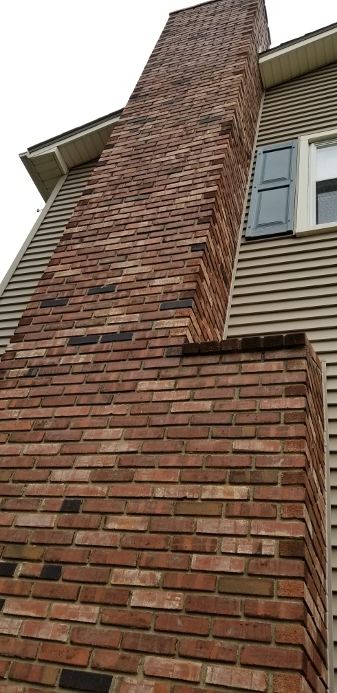

My install was 15+ years ago, so I have no idea the manufacturer of the liner. Both installers were using the same flex liner though. I do know that my insert manufacturer did not require an insulated liner. Like I said, I wanted one, but three "professionals" told me it wasn't necessary to insulate the liner in an existing clay tile stack. I say professional, but anyone in the business can refer to themselves as a "professional" or "certified". Hence why I met with my fire code inspector first before having the install done. Maybe all code inspectors aren't as diligent as mine was. He actually read the specs on both the insert and liner as it was all submitted for the permit and checked at the final.
Sorry to the OP for going off topic. Your local inspector will ultimately have the final say whether one is required.... I'd also check with them for references. I have zero issues.

No code has final say unless the code inspector gives you a written and signed variance saying the code violation is ok. If they just miss it or as in most cases don't know the actual code it is still not compliant and who ever installed it is on the hook for the liability. Code inspectors are not liable unless they give out that variance. In your case unless they pulled that j chanel back or drilled test holes there is no way that they could have confirmed the proper clearances. It doesn't matter if your insert manufacturer didn't call for insulation. What matters is clearances and the ul listing of your liner.
