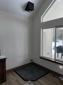

It is a vertical run all the way through the roof, there was no T installed on the external pipe for cleaning so I’m trying to learn how I can clean the entire chimney from inside. Here is a picture of the indoor set up. The jackwagons that built the house put the stove chimney in the wrong spot, it will not be centered over the stove so I will need a small offset near the top about 6 inches to 12 inches. These telescopin double wall sections, how long are they and am I going to need to seal the different sections of the chimney together? I’ve been reading contradictory things on that. Here is a picture of what I have

No sealing needed. Lengths vary allot depending upon manufacturers. I don't know about Kuma's but most stoves now let you clean right up through them

I found DVL double wall 45s, can they overlap or do the ends of the 45s need to be joined? I’m not sure exactly how much of an offset I’ll need. What do you recommend?
Look at a SootEater - you can clean from the inside up, either through the stove, or by (shortening and then) taking out the telescoping piece. The offset won't be an issue for such cleaning. Many folks do it this way.
The only thing to take care of is to keep the room clean; if you go through your stove up that should be fairly easy (but you may need to clean above baffles in the stove etc.). If you take a piece of stove pipe off your stove and then go up, use a plastic bag taped to the pipe with a small hole in it through which you feed the rods.

The single wall indeed robs heat from the flue gases. The question is whether that is smart or not; you need to be able to keep the gases above 212 F (I'd say above 230 F) at the tip, or you'll get creosote condensation. Hence double wall, or insulated etc.
In your case the flue is not too long (so not a lot of cool down along the way), but the Kuuma (I think) will have fairly low exhaust temps. So I think it's safer to go with the double wall. Also double wall is more durable as noted by Kenny.
Moreover, I don't know how tall your total flue stack is, and what Kuuma requires. If you're close to the minimum required, I'd go double wall. Because retaining heat in the gases will increase the draft (and if you're close to the minimum required height, you're close to the minimum draft for the stove to function).
Regarding the 45s "overlapping", I'm not sure what you mean. Yes, you can connect two 45's back to back. (But if you are talking about cutting pieces to make them overlap, I would advise not to do that.)

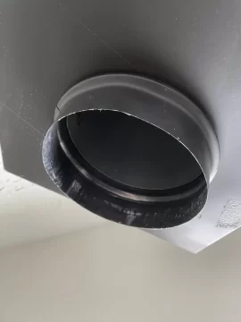

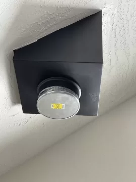

I just got my stove and the guy seemed very knowledgeable about everything. I was talking to him about my chimney and he was saying that the manufacturer of whatever pipe I get needs to match the manufacturer of the ceiling piece. Is this accurate? Do I need to find out the brand of this peice from the installer? This is a close up of my ceiling piece. [Hearth.com] Internal piping question

And yes, don't combine manufacturers in the system. All one brand. Safest that way. And tested that way.

Does my cieling box look like it will accept double wall pipe? I’m not sure of the physical differences. Kuma told me I should use double wall
