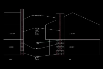

I purchased a house 3 years ago that has a fireplace in the basement; which I completely remodeled into a game room (16x24). The fireplace is a prefab one a 6" metal liner IIRC. I'd like to purchase a wood-burning insert for it. I imagine this can be considered a Zero-Clearance Fireplace. But being that it's in the basement it isn't framed in with wood like it would be on the first floor, it's incased in the foundation block from the basement floor to the first floor. From the first floor to the opening is 2x4 framed with vinyl siding (Casing is the technical term?). I know they make inserts that can go into Zero-Clearance Fireplaces.
Now, my issue is, the fireplace itself has a few holes in it. The liner and fireplace were inspected and the liner's in good shape but he said the firebox needed replaced.
Since the firebox is in the basement and incase in concrete block, can I weld up the holes and stick an insert in the opening or do I have to replace the firebox and then get an insert. Or would it be best to get a new prefabricated fireplace? Or could I just get a stove and tap it into the existing steel liner and remove the old firebox?
Attached is an illustration of my chimney.
Thanks,
Rob

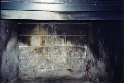

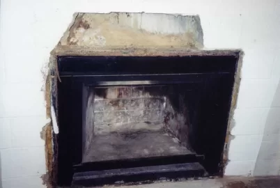

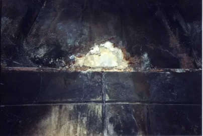

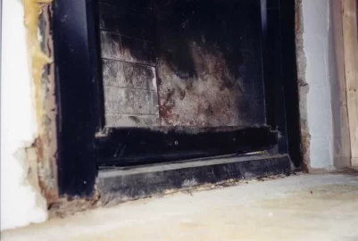

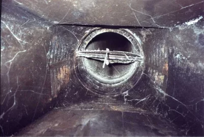

It is a metal box in the wall that tapers up into a metal chimney flue. I have to scan the pictures I have, I'll post them tomorrow.
OK, found my pictures. Hopefully this will help out.

I don't know but that one doesn't look like a place I'd put an insert. I'd put in a stove and a full reline. Maybe a Hearthstone Homestead hearth mount.
I like the idea of getting a stove and tapping into the liner, but only with a strong assurance that the liner is AOK and has a long life. That corrosion at the rear of the firebox is a bit unsettling. If the liner is not high-grade, stainless in great condition, then I'd replace it too.
some observations I have to question why there is a liner in that prefab fireplace flue pipe? The only reason I can figure it that the original vent pipe deteriorated past being safe.
Judging from the damage from your pictures that fireplace is no young chicken I doubt the original chimney meets any safety standards of today. Not only has the fire box rusted threw but there are also signs of metal fatigue as well Welding a plate to fatigued metal does not work out all that well. In all probibility the welds will burn threw it. Mighty hard to weld thin fatigued rusted metal with any sucess.
I second the suggestions to tear everything out and start over again. There are too many hints, that safety could be compromised to suggest any other solution.
