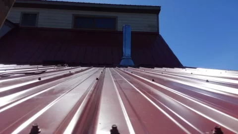

Well that sucks. Sorry to hear it happened. From the pictures, it looks like you have 10 feet of vertical stove pipe which may not be enough to create the draft the stove needs. But then again in your part of the country you may experience more draft issues just because it doesn't get cold enough to create proper draft.
I say do a few test burns while you are home and awake, keeping an eye on the fire. Take note of the outside temps too as it may be a certain temp that messes with your draft.

Frankly, I'm surprised at how many times in Florida we've had this guy up and running since install of October last year (2017). To Cantbe03, you're right about having to plan for it. We've actually tweaked a way of "shutting it down" which doesn't involve it running out of pellets completely. It's kind of a pain and takes about 25 minutes (to be 100% sure / safe), but it's nice to have the option.
We've since pulled it away from the wall a bit more. Prior, we made the 1" clearance to combustibles but it was a pain to access the control panel. We added two 45 degree elbows and a small 6" section which allows it to sit just right.
We also started "trusting" it to run while we're sleeping. It took a lot of time to get to that point. However, hypothetically speaking, what if the power goes out with the stove running? That had me concerned. The internal alarm sensors wouldn't activate and let us know something was wrong. Do others have this concern? It was just a though. We had it running last night and we'll probably run it again tonight too (will be in the 30's, but that's cold for us!).
