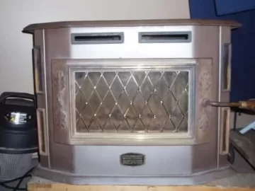

i have a country comfort wood stove taht i bought off of craigs list 2 weeks ago and i have finally gotten the manual for it and it all the pictures that are listed in the manual it shows the stove on a pedestal, with a blower an all. when i purchased it it did not have a pedestal with the blower. do i need to have a pedestal with the one that i have? if so does it matter which one i buy? or can it sit with out it? not sure if i need to go and get one? any help would be greatly appreciated.... model # cc200

Can you attach pictures?
uhhhh lok at the pictures and you let me know..... nope no legs...
No legs? nope right now sitting on a dolly till we get it installed
So it just sits on the floor? yep
Is this an insert for a fireplace or a freestanding wood stove? not sure you tell me?

It is a fireplace insert. It does not use legs or a ped. Without a blower it is pretty much a very heavy doorstop.
I do not know if you can use an insert like a free-standing, and if you could, I do not think it would pass inspection.

I think the thing you have in the picture is an insert. The pic in the previous post only vaguely resembles what you have shown in YOUR pic.
We had a chance to look at the bottom and it looks like a pedestal was attatched at some point.has old marking of a previous pedestal. We are going to see if local dealer has one that will fit. Also the manual that came with the stove shows several different installs like a freestanding stove not as a fireplace insert. But I will call Dan at follsabee steel in the morning to verify that it is not an insert and what we could use as a pedestal. I will keep u posted
ok so here is the deal... i called follanbee steel and spoke to dan and he told me that if the manual shows the stove with a pedestal then it is a freestanding stove and not an insert... now the question is where can i get a pedestal for the stove that i have. anyone have any suggestions?
ok we have a solution. i spoke to our inspector in out area and he stated that we could use a material that is non combustiable (brick, cement blocks or something of that sorts) since we do not have the pedestal or legs. so does anyone have any suggestions as to what type of material to use that can withstand high heat and wont break down because of the heat? anyone have any pictures that may help with building out pedestal?

You could have a local welding shop make up something for you. Paint it black with high heat paint, and it'll look like it belongs there.
